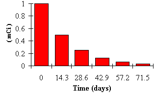

The half-life of a material is the time it takes for half of the material to have decayed away. For example if you have one mCi of a material with a half life of 14.3 day, then after those 14.3 days only .5 mCi of the material will be left. AFter 28.6 days only .25 mCi will be left.Each radionuclide decays at its own unique rate which cannot be altered by any chemical or physical process. A useful measure of this rate is the half-life of the radionuclide. Half-life is defined as the time required for the activity of any particular radionuclide to decrease to one-half of its initial value.  In other words one-half of the atoms have reverted to a more stable state material. Half-lives of radionuclides range from microseconds to billions of years. Half-life of two widely used industrial isotopes are 74 days for iridium-192, and 5.3 years for cobalt-60. More exacting calculations can be made for the half-life of these materials, however, these times are commonly used.
