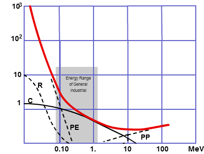

The attenuation that results due to the interaction between penetrating radiation and matter is not a simple process. A single interaction event between a primary x-ray photon and a particle of matter does not usually result in the photon changing to some other form of energy and effectively disappearing. Several interaction events are usually involved and the total attenuation is the sum of the attenuation due to different types of interactions. These interactions include the photoelectric effect, scattering, and pair production. The figure below shows an approximation of the total absorption coefficient, (µ), in red, for iron plotted as a function of radiation energy. The four radiation-matter interactions that contribute to the total absorption are shown in black. The four types of interactions are: photoelectric (PE), Compton scattering (C), pair production (PP), and Thomson or Rayleigh scattering (R). Since most industrial radiography is done in the 0.1 to 1.5 MeV range, it can be seen from the plot that photoelectric and Compton scattering account for the majority of attenuation encountered.

Photoelectric (PE) absorption of x-rays occurs when the x-ray photon is absorbed, resulting in the ejection of electrons from the outer shell of the atom, and hence the ionization of the atom. Subsequently, the ionized atom returns to the neutral state with the emission of an x-ray characteristic of the atom. This subsequent emission of lower energy photons is generally absorbed and does not contribute to (or hinder) the image making process. Photoelectron absorption is the dominant process for x-ray absorption up to energies of about 500 KeV. Photoelectron absorption is also dominant for atoms of high atomic numbers.
Compton scattering (C) occurs when the incident x-ray photon is deflected from its original path by an interaction with an electron. The electron gains energy and is ejected from its orbital position. The x-ray photon loses energy due to the interaction but continues to travel through the material along an altered path. Since the scattered x-ray photon has less energy, it, therefore, has a longer wavelength than the incident photon. The event is also known as incoherent scattering because the photon energy change resulting from an interaction is not always orderly and consistent. The energy shift depends on the angle of scattering and not on the nature of the scattering medium.
Pair production (PP) can occur when the x-ray photon energy is greater than 1.02 MeV, but really only becomes significant at energies around 10 MeV. Pair production occurs when an electron and positron are created with the annihilation of the x-ray photon. Positrons are very short lived and disappear (positron annihilation) with the formation of two photons of 0.51 MeV energy. Pair production is of particular importance when high-energy photons pass through materials of a high atomic number.
