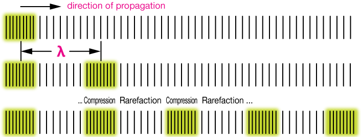

Periodic Longitudinal Wave
Longitudinal waves can also be periodic. As a longitudinal wave travels there are regions of high particle density or pressure and regions of low particle density or pressure. These regions are called compression and rarefaction, respectively, and are shown in the figure below. Just like with a transverse periodic wave, a periodic longitudinal wave has a wavelength that is the physical distance between two same points in the pattern. In this case the wavelength can be defined as the distance between two compression regions or two rarefaction regions.
