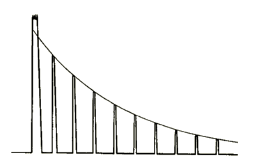

Relative measurements such as the change of attenuation and simple qualitative tests are easier to make than absolute measure. Relative attenuation measurements can be made by examining the exponential decay of multiple back surface reflections. However, significant variations in microstructural characteristics and mechanical properties often produce only a relatively small change in wave velocity and attenuation.
Absolute measurements of attenuation are very difficult to obtain because the echo amplitude depends on factors in addition to amplitude. The most common method used to get quantitative results is to use an ultrasonic source and detector transducer separated by a known distance. By varying the separation distance, the attenuation can be measured from the changes in the amplitude. To get accurate results, the influence of coupling conditions must be carefully addressed. To overcome the problems related to conventional ultrasonic attenuation measurements, ultrasonic spectral parameters for frequency-dependent attenuation measurements, which are independent from coupling conditions are also used. For example, the ratio of the amplitudes of higher frequency peak to the lower frequency peak, has been used for microstructural characterization of some materials.
