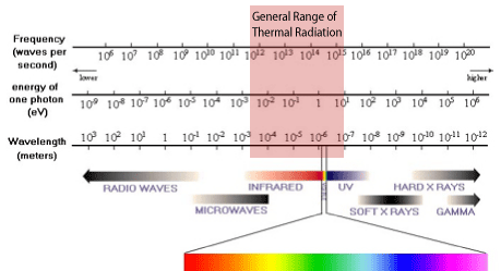

The wavelength of thermal radiation extends from 0.1 microns to several hundred microns. As highlighted in the image, this means that not all of the heat radiated from an object will be visible to the human eye… but the heat is detectable. Consider the gradual heating of a piece of steel. With the application of a heat source, heat radiating from the part is felt long before a change in color is noticed. If the heat intensity is great enough and applied for long enough, the part will gradually change to a red color. The heat that is felt prior to the part changing color is the radiation that lies in the infrared frequency spectrum of electromagnetic radiation. Infrared (IR) radiation has a wavelength that is longer than visible light or, in other words, greater than 700 nanometers. As the wavelength of the radiation shortens, it reaches the point where it is short enough to enter the visible spectrum and can be detected with the human eye.

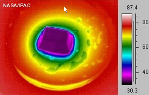

An infrared camera has the ability to detect and display infrared energy. Below is an infrared image of an ice cube melting. Note the temperature scale on side, which shows warm areas in red and cool areas in purple. It can be seen that the ice cube is colder than the surrounding air and it is absorbing heat at its surface. The basis for infrared imaging technology is that any object whose temperature is above 0°K radiates infrared energy. Even very cold objects radiate some infrared energy. Even though the object might be absorbing thermal energy to warm itself, it will still emit some infrared energy that is detectable by sensors. The amount of radiated energy is a function of the object's temperature and its relative efficiency of thermal radiation, known as emissivity.
