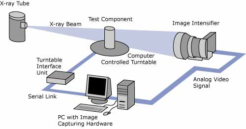

Computed Tomography (CT) is a powerful nondestructive evaluation (NDE) technique for producing 2-D and 3-D cross-sectional images of an object from flat X-ray images. Characteristics of the internal structure of an object such as dimensions, shape, internal defects, and density are readily available from CT images. Shown below is a schematic of a CT system.
The test component is placed on a turntable stage that is between a radiation source and an imaging system. The turntable and the imaging system are connected to a computer so that x-ray images collected can be correlated to the position of the test component. The imaging system produces a 2-dimensional shadowgraph image of the specimen just like a film radiograph. Specialized computer software makes it possible to produce cross-sectional images of the test component as if it was being sliced.

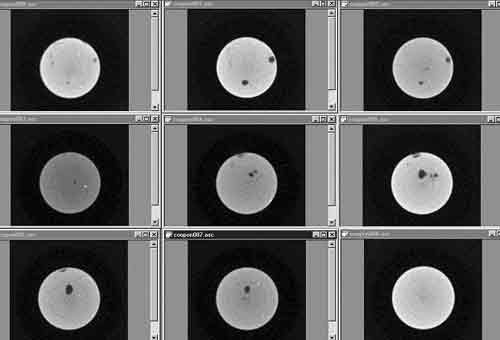

CT slices through several locations of a specimen are shown in the set of images below.

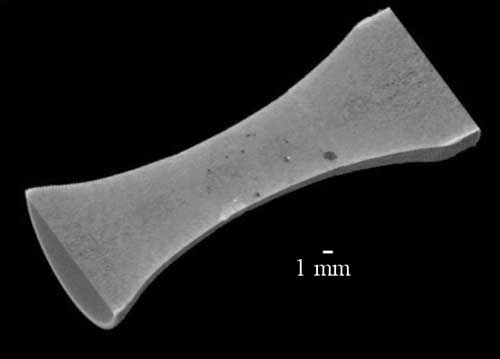

A number of slices through the object can be reconstructed to provide a 3-D view of internal and external structural details. As shown below, the 3-D image can then be manipulated and sliced in various ways to provide thorough understanding of the structure.
