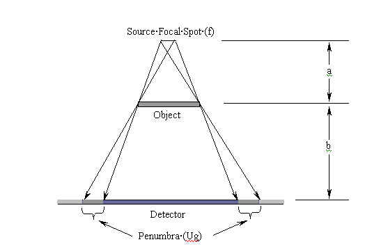

When magnification is used in an RTR system, the geometric unsharpness of the inspection setup needs to be taken into consideration. The size of the X-ray tube focal-spot and the magnification factors, namely the source-to-specimen and specimen-to-detector distances, are used to calculate the geometric unsharpness of the inspection setup. Geometric unsharpness (Ug) is determined as follows:
f = X-ray generator focal-spot size.
a = distance from x-ray source to front surface of material/object
b = distance from the material/object to the detector
To minimize the penumbra, the test specimen is usually placed as close as possible to the detector and the source is placed some distance from the sample. A greater distance between the source and the object will reduce geometric unsharpness. However, the intensity of the source decreases as the distance increases. Therefore, the source should be placed only as far away as necessary to control the penumbra. If the test object is placed in direct contact with the detector (like is often done in film radiograph) the following formula can be used that takes into account the material thickness instead of the object-to-detector distance. This formula is:
f = X-ray generator focal spot size
t = the thickness of the material
d = distance from x-ray source to front surface of material/object
