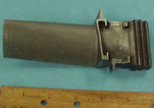

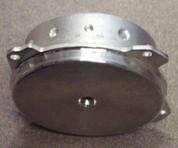

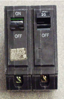

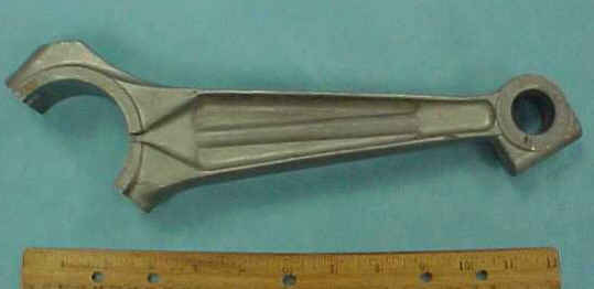

More complex analysis may involve the program’s algorithm to determine whether, in a certain ROI, there are any deviations such as discontinuities, pores, cracks, or inclusions. The RTR system may be tasked with automatic inspection (without operator interaction), making various required checks and proper archival records all at a relatively high rate of speed. Figures 18 through 22 show some of the different objects that are inspected with RTR systems but almost any component could be inspected use RTR.
