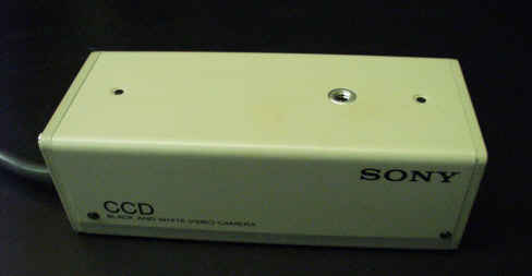

Charged couple device (CCD) cameras are very popular in RTR systems and have solid-state electronics consisting of a very small semiconductor chip. The chip is made up of discrete elements (pixels), which receive light and create a voltage and a current directly corresponding to the amount of light received. This same technology is used in home video camcorders and digital cameras. See figure 11 for an example of a CCD camera. The image is not recorded on film by means of grains of silver; rather, the voltage produced creates an RS170 signal either to produce an image on a monitor or to record the image on a VCR tape, CD or other means.
