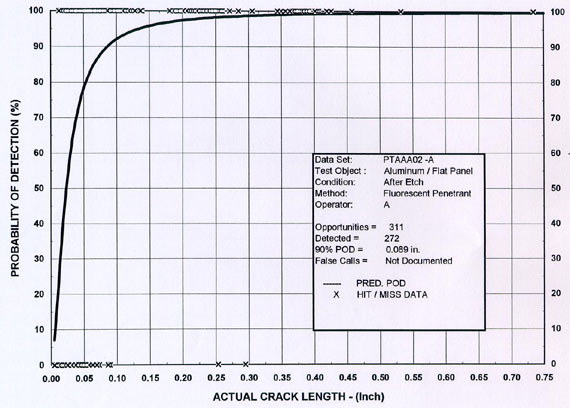

The top curve shows the probability of detecting a crack versus crack length for as-machined aluminum specimens. The bottom curve shows the POD for the same aluminum specimens after their surfaces had been etched. Comparing the crack lengths where the curves reach a POD level of 90%, it can be seen that in the as-machined condition, the crack length would need to be 0.4 inches long. However, when the surface is etched, cracks under 0.10 inch can be detected with a 90 % probability.

Etching of the specimens can return the flaw to the pre-mechanical processing level of detectability. The amount of material that must be removed by the etching process depends on the amount of material that has been smeared and should be determined experimentally. Volume two of the Nondestructive Testing Handbook provides a great deal of information on material smearing and the amount of etching required to remove a smeared metal. The handbook includes a number of photographs such as the set below that graphically show the effects of metal smearing.
