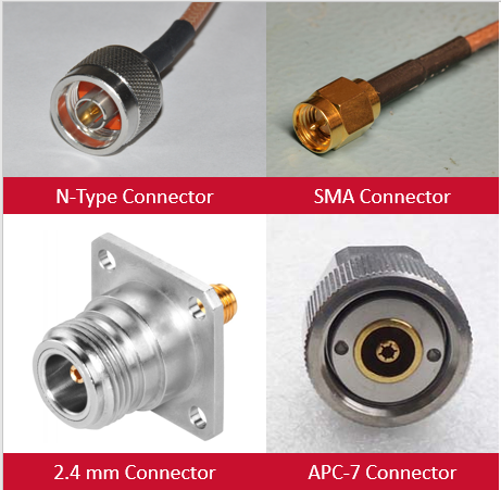

When making a measurement with a network analyzer, the user begins by connecting a probe, antenna, or device-to-be-tested to the network analyzer through high-quality coaxial cables. A coaxial cable is a type of transmission line that consists of an inner conductor and an outer conductor separated by some type of dielectric material. Coaxial cables can support a very wide range of frequencies and are terminated in different types of connectors and adapters. Some common types of connectors and adapters include N-Type, SMA, 2.4 mm, and APC-7. Each of these has a different frequency range of operation.

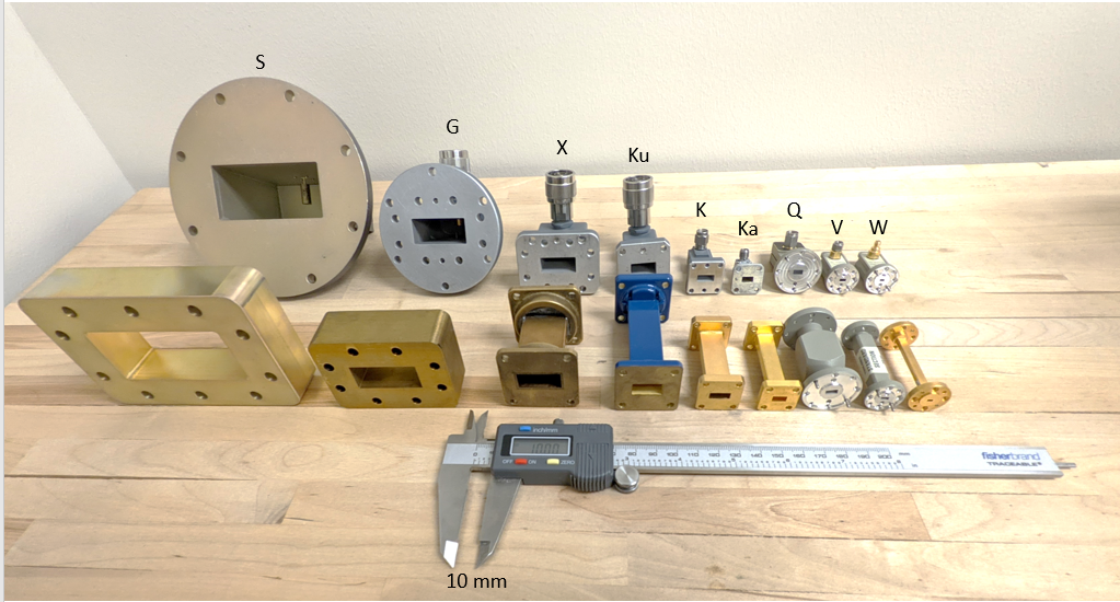

Another common type of probe used in microwave NDE is an open-ended waveguide. Standard waveguides, with rectangular and circular cross-sections, operate in a certain range of frequencies as a function of their broad or radius dimensions, respectively. Rectangular waveguides more commonly used in practice, particular as an interrogating probe. Examples of rectangular waveguide to coax adapters and waveguide sections that are labeled with their waveguide band designation are shown in the picture below. The Table below lists the dimensions, operating frequencies, and designations of all rectangular waveguides in the microwave and millimeter wave frequency ranges. The picture and table show that as the operating frequency decreases, the waveguide size increases and vice versa.
For additional information about waveguides the reader may consult one of many available reference textbooks or web sites.
Waveguide to coax adapters and waveguide sections covering 2.6 to 110 GHz.
Rectangular Waveguides for Microwave and Millimeter Waves

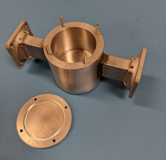

While coaxial probes and waveguides are commonly used in microwave NDE due to their versatility and simplicity of use, other types of probes, antennas, and devices can also be used depending on the application. Examples of these include horn antennas, microwave cavities, and microstrip resonators. When performing microwave imaging, the measurement systems can also be quite varied as a function of the type of imaging performed (e.g., near-field, lens-focused or synthetic aperture radar (SAR)). More about equipment in the context of specific applications will be discussed in the upcoming sections.
Horn antenna (left) and microwave cavity (right).
