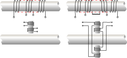

Eddy current probes are available in a large variety of shapes and sizes. In fact, one of the major advantages of eddy current inspection is that probes can be custom designed for a wide variety of applications. Eddy current probes are classified by the configuration and mode of operation of the test coils. The configuration of the probe generally refers to the way the coil or coils are packaged to best "couple" to the test area of interest. An example of different configurations of probes would be bobbin probes, which are inserted into a piece of pipe to inspect from the inside out, versus encircling probes, in which the coil or coils encircle the pipe to inspect from the outside in. The mode of operation refers to the way the coil or coils are wired and interface with the test equipment. The mode of operation of a probe generally falls into one of four categories: absolute, differential, reflection and hybrid. Each of these classifications will be discussed in more detail below.

Differential probes have two active coils usually wound in opposition, although they could be wound in addition with similar results. When the two coils are over a flaw-free area of test sample, there is no differential signal developed between the coils since they are both inspecting identical material. However, when one coil is over a defect and the other is over good material, a differential signal is produced. They have the advantage of being very sensitive to defects yet relatively insensitive to slowly varying properties such as gradual dimensional or temperature variations. Probe wobble signals are also reduced with this probe type. There are also disadvantages to using differential probes. Most notably, the signals may be difficult to interpret. For example, if a flaw is longer than the spacing between the two coils, only the leading and trailing edges will be detected due to signal cancellation when both coils sense the flaw equally.
