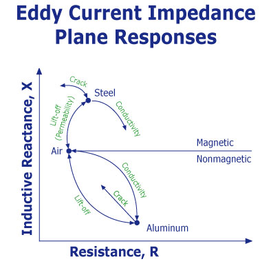

You will recall that this can be graphically displayed using the impedance plane diagram as seen above. Impedance also has an associated angle, called the phase angle of the circuit, which can be calculated by the following equation.
The impedance plane diagram is a very useful way of displaying eddy current data. As shown in the figure below, the strength of the eddy currents and the magnetic permeability of the test material cause the eddy current signal on the impedance plane to react in a variety of different ways.
If the eddy current circuit is balanced in air and then placed on a piece of aluminum, the resistance component will increase (eddy currents are being generated in the aluminum and this takes energy away from the coil, which shows up as resistance) and the inductive reactance of the coil decreases (the magnetic field created by the eddy currents opposes the coil's magnetic field and the net effect is a weaker magnetic field to produce inductance). If a crack is present in the material, fewer eddy currents will be able to form and the resistance will go back down and the inductive reactance will go back up. Changes in conductivity will cause the eddy current signal to change in a different way.
When a probe is placed on a magnetic material such as steel, something different happens. Just like with aluminum (conductive but not magnetic), eddy currents form, taking energy away from the coil, which shows up as an increase in the coils resistance. And, just like with the aluminum, the eddy currents generate their own magnetic field that opposes the coils magnetic field. However, you will note for the diagram that the reactance increases. This is because the magnetic permeability of the steel concentrates the coil's magnetic field. This increase in the magnetic field strength completely overshadows the magnetic field of the eddy currents. The presence of a crack or a change in the conductivity will produce a change in the eddy current signal similar to that seen with aluminum.
