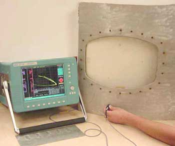

Corrosion Thinning of Aircraft Skins
One application where the eddy current technique is commonly used to measure material thickness is in the detection and characterization of corrosion damage on the skins of aircraft. Eddy current techniques can be used to do spot checks or scanners can be used to inspect small areas. Eddy current inspection has an advantage over ultrasound in this application because no mechanical coupling is required to get the energy into the structure. Therefore, in multi-layered areas of the structure like lap splices, eddy current can often determine if corrosion thinning is present in buried layers.
Eddy current inspection has an advantage over radiography for this application because only single sided access is required to perform the inspection. To get a piece of film on the back side of the aircraft skin might require removing interior furnishings, panels, and insulation which could be very costly. Advanced eddy current techniques are being developed that can determine thickness changes down to about three percent of the skin thickness.
