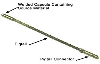

Physical size of isotope materials will very slightly between manufacturer, but generally an isotope is a pellet that measures 1.5 mm x 1.5 mm. Depending on the activity (curies) desired, a pellet or pellets are loaded into a stainless steel capsule and sealed. Unlike X-ray tubes, radioactive sources provide a continual source of radiation that cannot be turned off. Once radioactive decay starts, it continues until all of the atoms have reached a stable state. The radioisotope can only be shielded to prevent exposure to the radiation. In industrial radiography, the instruments that are used to shield the radioisotope so that they can be safely handled and used are commonly called cameras or exposure devices. Exposure devices will be discussed later in more detail.
Pigtail devices can be used to handle radioactive materials.
